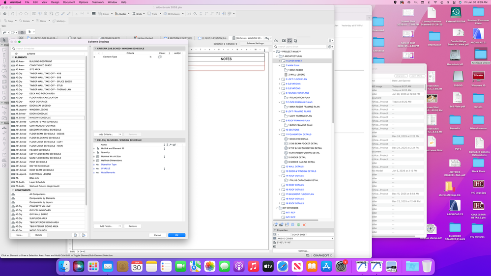

Having a problem with my window schedule. Cannot get anything to show up. Changed the walls from new to existing and nothing shows up.
Setup info provided by author

What are the criteria for your window schedule?
How does it differ from the door schedule?
Could you post a screenshot of your Scheme Setup Dialog that shows the criteria used for the schedule?

You need to show us your schedule criteria settings.
Otherwise we are just guessing blindly.
mukster
Ricardo Lopez
Hi @mukster
Could you share the view settings of the schedule too? There should be a Renovation filter option to check.
