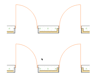

When I ctrl+M+shift after hotlink, the door changes
This is a case of ctrl+shift+D after hotlink and then ctrl+M.
this is door entrance door 25.
this is bbb.pln ( aaa.mod -> bbb.pln : hotlink)
The one above is ctrl+shift+M
The bottom one is ctrl+shift+D followed by ctrl+M

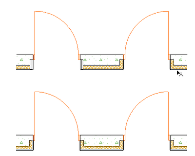

this is ccc.pln ( aaa.mod -> bbb.pln -> ccc.pln : hotlink)

Peter Baksa
this is a known bug, AC_Wall_Direction_Type will be wrong with Ctrl-Shift-M.
There is a workaround: move the hotlink after creating the mirrored copy..
