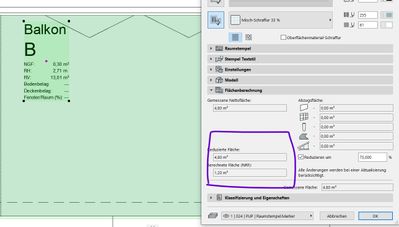

Do you maybe also know how to show on the list reduced Zone Volume? I can see the reduced area, but the volume stay calculated 100%, even though i reduce them for 75%.
I would like to use the reduced are in the volume calculation and then show it on the list. Is that possible? 🙂
So you would like to have a Schedule Field that displays the volume of your Zone after being reduced by 75% so instead of the 13.01 m3 displayed in your screenshot it displays 3.25 m3?
For that you can create a Property for Zones and use an Expression to multiply the Zone Volume parameters with 0.25. Then you can use that Property in your Schedule as a field.

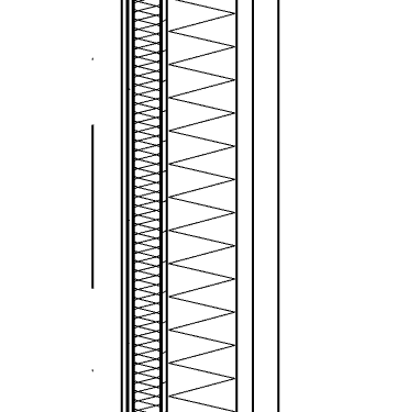

so, I have a material that is built out of wooden stands and the insulation in between:
but in Archicad I simply use one material for it, just the insulation:
The wall consists of more layers, but we onyl consider one material here (the insulation in the middle).
I would like to make a list of materials, where this insulation is listed 10% as wood (these wooden stands) and 90% as insulation.
I believe somehow this could be achieved with material properties? 🙂
Thank you for helping me!
or it might be easier, I simply make this wood stands in the wall? But then I would have to change a wall into a profile, right?
