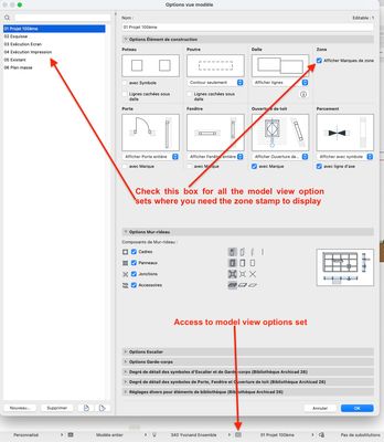

BrunoH
Due to a new ArchiCad 26 feature the default model is set to hide the zones stamps.
You can now Label Zones and it's set by default.
Change the model view option sets.
ArchiCad 3.43 to 28
MacOS Monterey
Go to post

Gaston
Thanks Bruno H.
Yes it now works
