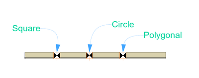

That's weird. The opening shape is available in labels (at least in AC28 which I tested):
Can you share your expression for us to try?

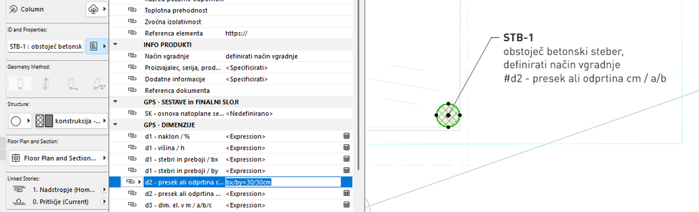

Sorry for not replying. The problem still persists:
In the screen capture above you can see the label, where the bottom line should display the property value. On the left we have element properties tab where property value is displayed correctly (blue highlight).
Im using AC 28.3.0. (6000) INT
This particular property and others that read element dimensions and format them into appropriate format depending on element type & shape worked when I created them. Ive tested them in plan and schedules at least. Must be something I did in the template that broke the property value display in autotext label. What could it be?

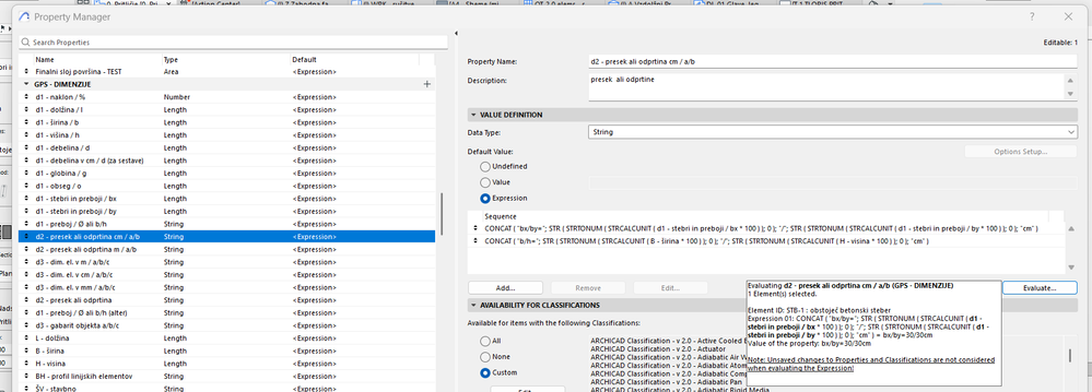

Rastko Pecar
Property also works in property manager if I click "Evaluate...":
It's a bit tough because I'm not familiar with your language.
Does 'd1 - stebri in preboji' work in labels?
Could you export your expressions and upload here for us to test?
