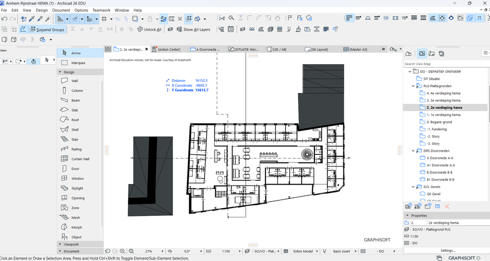

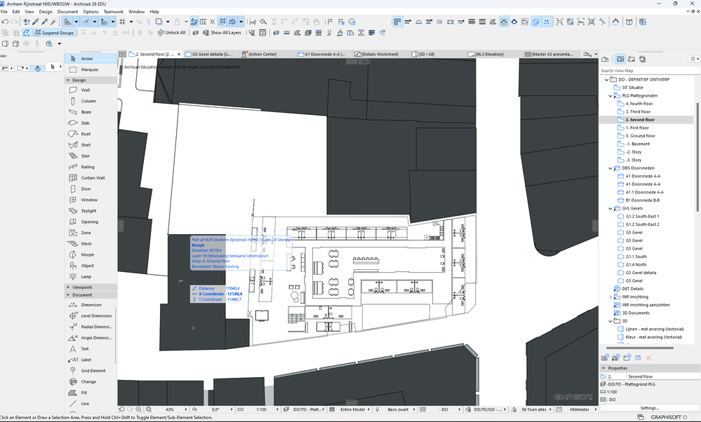

I have a problem with the visible and not visible walls in 2 different files. I have 2 different files because i have 2 design with different storey settings. Therefore I created a hotlink between those files. When i put the my hotlink in the main design, the walls become not visible but the interior is. I have looked into the layer setting but everything is the same. On the ground floor and 3D views is everything what is supposed to be. But in the other storeys the walls become not visible.

yes that layer is also on. I can see the walls and floors on the ground floor and first floor, but on the second floor and third floor the walls dissapear but the interior is visible.

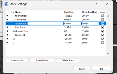

I think that this has something to do with the different story settings between the main file and hotlink. the main file belongs to the first image with the story's of 2960. the hotlink file has story's with 5000. So my reasoning is that the cut plane is linked with the main file on the half of each story from the 2960. And that it cuts through the hotlink file.
Is it possible to change this in some way that the cut plane of the main file is still the same and that the cut plane in the hotlink file is different?

Hi Miel,
You're right your problem comes from the different story's height between the two files.
In this case, in the module file, set the walls to "Symbolic cut" or "Contour only" depending on how they should appear.
