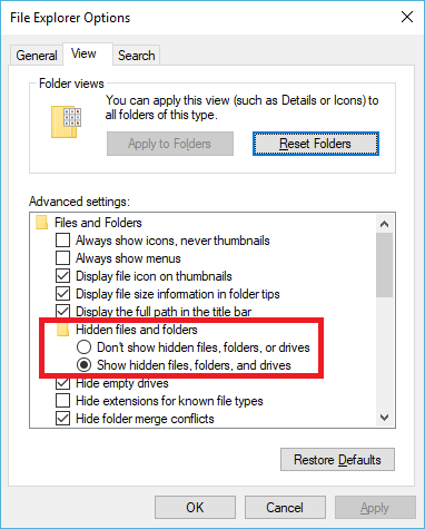

Info_18x18.png No AppData folder? It is often hidden by default. You can show hidden files and folders. To do this you need to open Control Panel and go to File Explorer Options. Open the View tab and under Hidden files and folders tick the second radio button shown on the image below:
