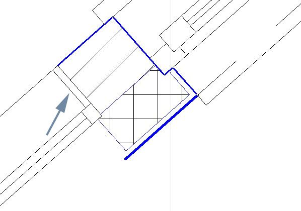

Hey,
it is a stupid question, but after hours reading the manual, searching in menus.... please
1.) where i can find the CONTOURS-settings inside DW???
2.) the interior reveal - by unchecking interior reveal (symbol-plan view items) i can get rid of it in plan view, but it shows up in section view, where i can get rid of it?
THANKS
3 REPLIES 3
yeah : Wall Contours =1 / param. settings : works with windows
not available for doors
I assume your using the latest version of DWB v3.5 build 10.7.
1. Contour options are under the Symbol (fewer options) setting or the Symbol/Plan View Items(more options). They are the typical ArchiCAD options. This also works with doors.
2. By not displaying the interior reveal in the 2D symbol doesn't actually delete it from the 3D model. The section is generated from the 3D model so it shows up. To remove the interior reveal go to the Interior Trim (fewer options) setting or the Interior Trim/Sill+Reveal (more options)and type in zero for the thickness of the interior reveal, then the reveal is not generated at all, the window being the depth of the frame only.
Hope this helps.
Hope this helps.
thats it... easy it is.. thanks a lot!
