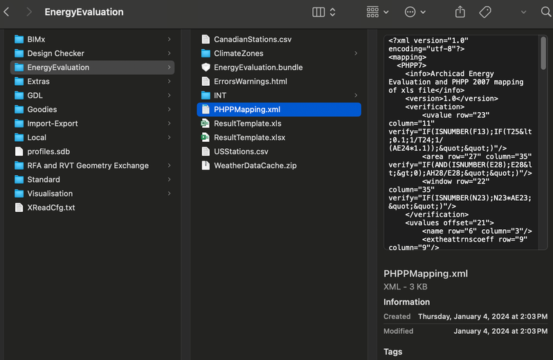

Hi Stuart, I'd love to try your workflow. You are presumably aware of the EcoDesigner XML file here called PHPP mapper? It needs a bit of love as it was never completed even for PHPP 9.6. But that may better capture shading, window depths, zone area and volume nuance better than custom scripts? Have you tried the EcoDesigner export flow or given any thought to updating it? It's quite a compact bit of code... but does what you are describing. Will go watch your video now... 🙂

I have tried to use the ecosesigner export on a number of occasions but it’s problematic for a number of reasons but mainly the lack of support - not just for the Phpp plugin but for ecosesigner in general which hasn’t been significantly upgraded since it was released as ecosesigner star.  The Phpp bit iOS not supported or upgraded by anyone at Graphisoft.  PHPP is on version 10.4 at least and this only works with version 9.6 of phpp.  PHPP 10 was released almost 3 years ago.
im not bothered about getting u-values or psi from archicad as it doesn’t calculate them according to the correct conventions anyway and Graphisoft seem to have no interest in changing either of them to work with PHPP conventions anyway.  I’m happy to add this data in PHPP anyway, I just want archicad to be able to drive the geometry data, and then possibly for PHPP to drive the data in archicad once the design is updated in that tool for now.
i would love someone to put Phpp inside archicad but that’s beyond my skill set - this is a workaround..!
ill have a look at the code though and see if I can adapt it for the current version of phpp though as it might work better and faster, but my coding isn’t great..!
