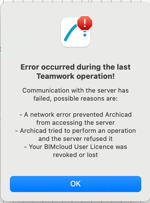

 Starting a new thread. Upgraded to 29.1. This user has only been working on doors and windows today. Had not edited layers or other view settings. Has not edited attributes. Total file size on the BIMcloud is just over 1GB.
the project does have a problematic library; they added libpacks AND lcf, so there are quite a few unplaced duplicates. I will be cleaning that up, but they are SOL unable to s/r...
Regardless; this hopefully reinforces that we STILL need Graphisoft to get bimcloud/teamwork/archicad in better working order. If bad library practices is all it takes to lose 4 hours of work, then archicad doesn't work. We need a better and more reliable tool.

Patrick M
Laszlo, this particular designer left the file open overnight and was able to send/receive successfully the following morning. After talking with GSNA, we are thinking this may have been a legitimate communication issue; due to slow internet or latency, possibly caused by a vpn bottleneck... While I'd like to think archicad could send and receive even with <20/20 internet speeds, I do have to acknowledge our file sizes are a bit insane; so I can't expect everything.
the libraries are cleaned now, but do not think that was a factor, as I didn't get to that until after she had sent the next morning.

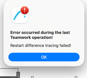

Patrick M
looks like maybe I forgot to knock on wood?
@Patrick M
As discussed previously in the other long Teamwork-related thread and asked by @Gordana Radonic, please keep one error message type per thread, so it can be discussed and possibly resolved. Therefore, I have removed your other two screenshots.
Please start separate threads for both, if you wish to discuss them or ask for help about them. This way, we can hopefully handle individual issues more effectively.
