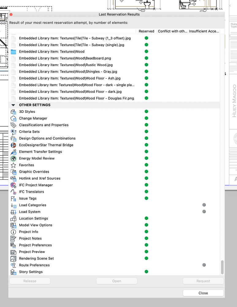

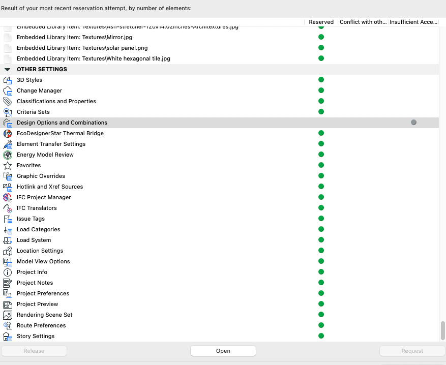

Seaboldarch
Same here.  Was just about to call support and log the issue with them.  I had my Lead Architect sign in with reserve all and she has a few more insufficient access points for Load Categories, Load systems, and route preferences, but she has access to design options and combinations.  Incidentally what machine are you working on?  I'm on an Apple Silicon machine with 14.4.1.  Just wanted to supply them with more information if I had it available.
Screenshot 2024-04-09 at 10.37.59 AM.pngScreenshot 2024-04-09 at 10.42.38 AM.png
I am on intel core i7 14700KF 3,4Gz, ... so it's not an intel or apple issue. It's really a bummer, the only work around so far is  to work on the project as a solo project.
