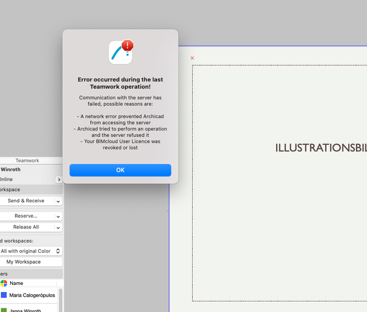

Hi!
We are experiencing problems with Archicad 29 and BIMcloud SaaS in our company. When working in a Teamwork file, we frequently encounter errors, or the system becomes very slow. Is anyone else experiencing the same issues? We don't see the same problems in Archicad 28.
This happened every day since november when we started working in AC29.
Kind regards,
Maria

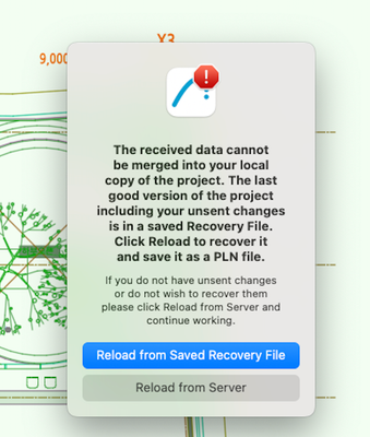

Lee KiSeong
I am experiencing the exact same issue. It is a terrible experience—the first time in 14 years I have encountered something like this. It is happening exclusively in Archicad 29.
AC 28 | M3 MAX | MAC OS 15
BIMcloud | Xeon Gold 6142 x 2 | WIN 11 PRO for Workstation
