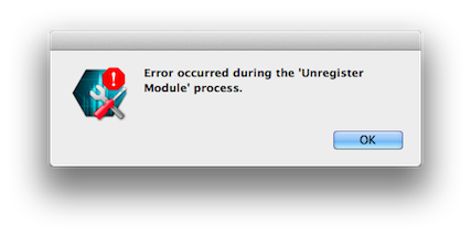

      • The following message might appear during the repair process, but this can be ignored
