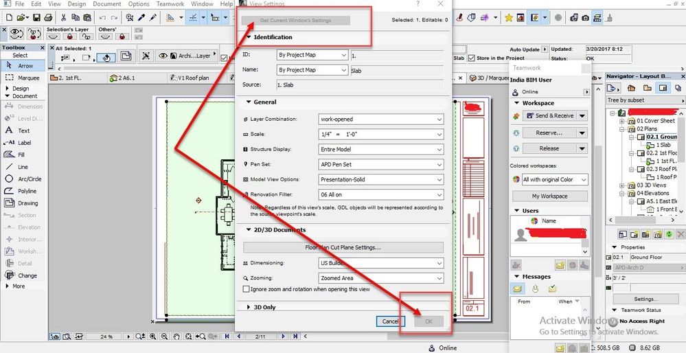

I am unable to modify view setting in layout. Please see screen shot.
Please suggest for solution.

It seems to me that you are trying to modify the settings of the View that is the source of the Drawing placed on the Layout.
Go to the View Map and reserve the View you wish to modify, then the OK button should become enabled.

Hi Laszlo Nagy,
Still ok button has not enable after reserving view set. wandering for solution yet

You reserved the View Set. Is there now a little green dot next to the View you wish to modify? Or can you also select that specific View and reserve that? (Sorry, I don't have BIM Server running so I am relying on memory on how this works.)
