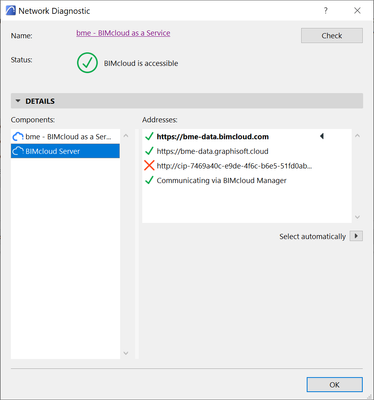

Open an Archicad and go to Teamwork > Project > Open / Join Teamwork Project... and on the server dropdown list, select 'Run Network Diagnostic Tool for <your BIMcloud's name>'.
Check the details: if you can see the BIMcloud Server on the list, or all addresses are red, then BIMcloud Server is not directly available from Archicad, and all communication goes through only the BIMcloud Manager. If it is good, then you see something similar like this:

These are the settings for our BIMcloud installation.

This looks good, so I suggest to check the other settings I mentioned. 🙂
