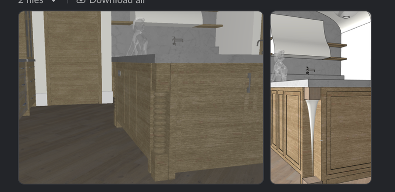

I'm really REALLY hoping this upcoming update (3/24?) fixes these kinds of issues...
user one adds a turned cabinet trim with a shell. user two does a s/r and sees... not the same thing...
teamwork isn't just unreliable, its wrong. its broken!
but I'm sure it's something in the file making a simple revolved shell show 2 different ways...
IDK, I'm not infallible. Maybe I'm missing a simple answer to this one... is there some MVO or shell setting that manages LOD that could make it show 2 different ways? none that I'm aware of.
