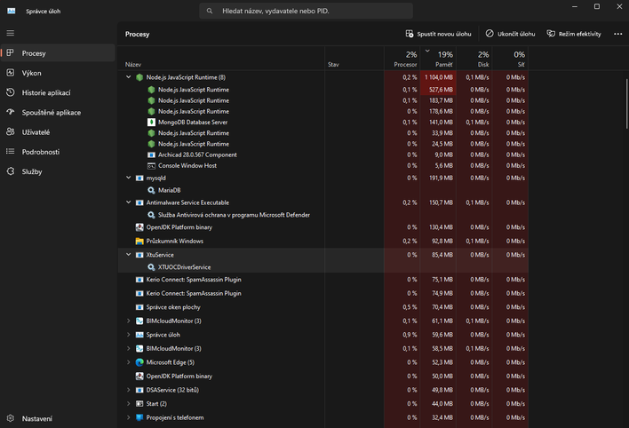

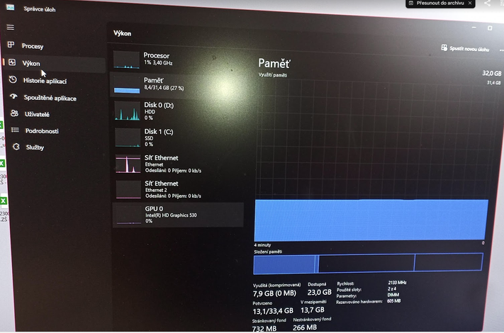

PC stats with system lag:

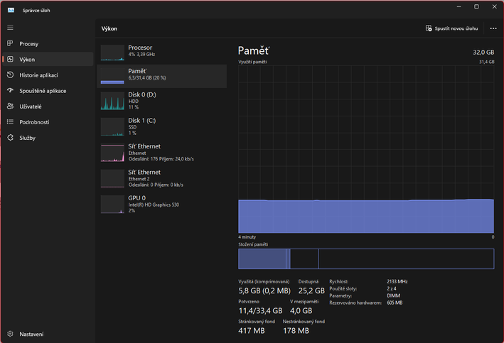

PC stat in fresh state, when all is running smoothly:
Thanks for help.
