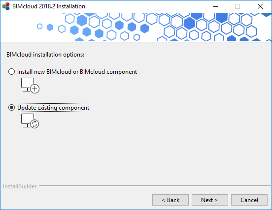

  2. Launch the downloaded BIMcloud installer package.
  3. Select the Update existing component option.

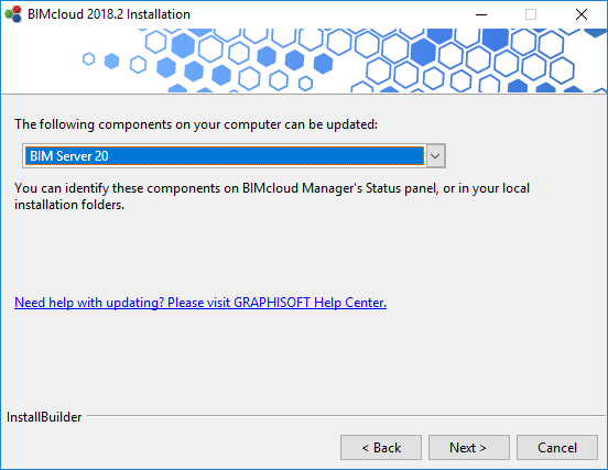

  4. Select the BIM Server version you want to update.
    This step will update the Manager component of your previous BIM Server.
  5. Finish the update process of the Manager component.

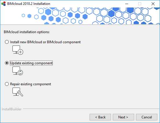

  7. Select the Update existing component option.
    The installer detects that a new version of a component (the Manager) has already been installed, so a repair option also appears. You may use this later for troubleshooting reasons.

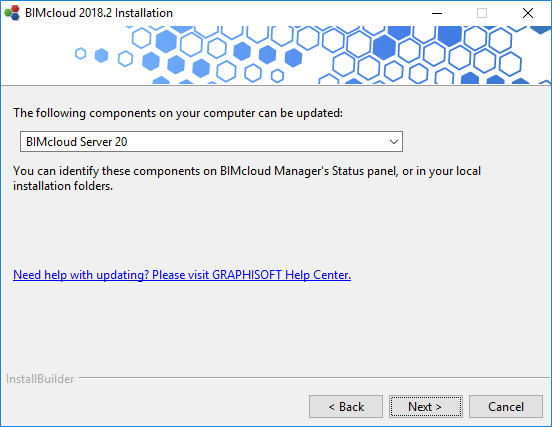

  8. Select the BIMcloud Server as a component and update it.
Repeat the above update steps with all installed BIM Server versions to update them to BIMcloud Basic. So if you have multiple BIM Servers installed, you will need to repeat these steps for each of them.
