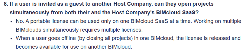

It's an unfortunate limitation, documented here:

Thanks.
I really think it's stupid. I'm the administrator of the company's Bimcloud. I can't disconnect from Bimcloud, and managing it is complicated. The collaboration aspect is limiting if you plan to work with users from different companies.
