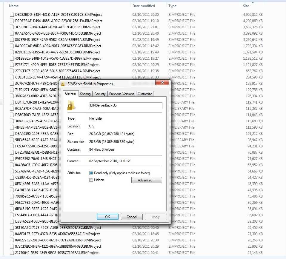

Not sure if have got my calculations correct, but to back up the data the BimServerBackupTool creates to 'the cloud' (currently 27Gig) would take 23.5hours @ 318kbps!

Do you really have 27Gb in your BIMSERVERBACKUP target folder? You would need to archive all your completed projects so you aren't uploading those every night. On top of the the actual project files the BIM server backup folder only consumes 70KB. My backup folder contains 1Gb of data which, at your upload speed would take about an hour.

26.8GB to be exact! 24GB approx in current projects, so archiving won't make that much difference.
If I understand you correctly, I'm not sure backing up new and used files using Sugarsync will help, the BimServerBackupTool is the only way to restore BimData (providing Graphisoft get their finger out and actually make it work!). What would be better is if the BSBUT backed up just new and changed files.
I'm reasonably IT literate but I'm not 100% sure I could stick a cloned HD into a fresh machine and it will work, maybe someone could advise.
With regard BimServer auto backups, we have never been able to restore these, maybe because of the size of the projects? So I will not be relying on these.
I think Graphisoft have some work to do on this MAJOR ISSUE, what also worries me (I don't know why it should) is that other users are plodding on backing up Bim data, not aware that it's useless and those who are using the BSBUT don't realise that it is not a reliable way to restore data.
