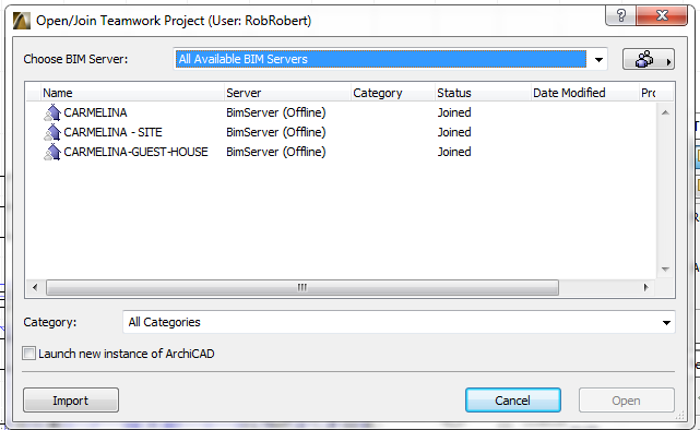

so....it appears to me that I can work "offline", then once I get connected to a TW file on someone elses server...I can simply "send changes" and that's that?
Please....someone....anyone...advise.
I'm collaborating on a residential project where the TW file resides on a 3rd parties server.
I'm getting a "OFFLINE" on the servers notification but I need to work.
Can I work on my most recent local copy, then once I reconnect...simply do a send changes and the TW file will be updated???

Yep.
Work offline... and send your changes when you go back online.
You can't edit any existing elements (unless you reserved them before going offline).
This Assumes no one "forced" you to leave the project while you were offline.
... and test it to be sure, incase I've misunderstood your question.

thanks Marc,
figure that's how its' "supposed" to work.
I'm the only one...for now...on this particular project so if anyone kicks me out...that'd be me
but.....it worked like you said.
once I was able to get 'reconnected' to the TW file on the server...did a send changes...and the model at the server accepted my changes....so that worked as it should have.
