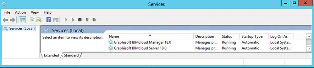

But both applications are running on the server

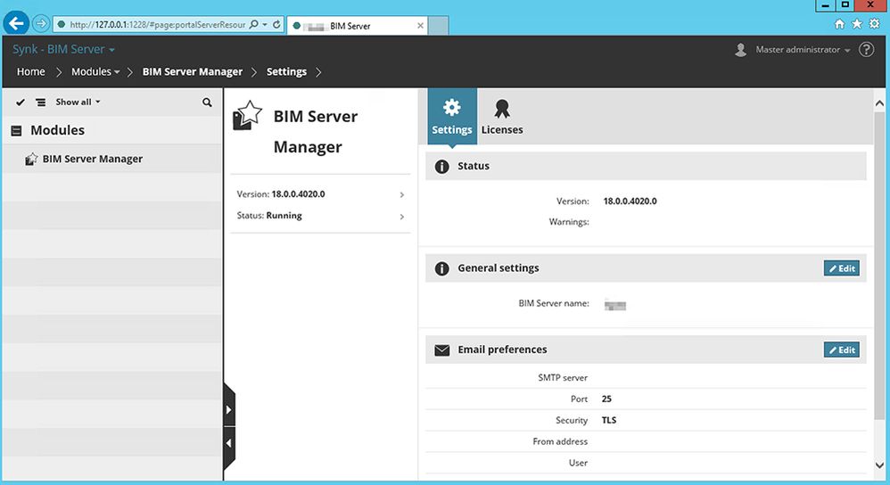

No, I only have the BIM server Manger under Modules
Thanks, this shows that the underlying BIMcloud Server could not be paired with the BIMcloud Manager.
We are aware of two sources, when such might fail during the installation:
- the localhost cannot be resolved on the 127.0.0.7 IP - to verify this try to access the browser based interface from the server itself: http://127.0.0.1:1228
If it fails, then verify that the hosts file contains an entry about this: http://www.rackspace.com/knowledge_center/article/how-do-i-modify-my-hosts-file
There should be a line (without being commented out with #):
127.0.0.1 localhost
- during the installation the allocated time for pairing is timed out - based on our experience repeating the installation several times helps to resolve this. A long term solution have been implemented in the code, but is not yet available in the installer you have
Keep me posted about the results,
Marton

I can access from local 127 IP from the server. What's next?

I have now unistalled, reinstalled, registrated the license and started BIM Server 18 on my server 4 times.
I can still access the 127 IP locally.
But I still only have BIM server Manger under Modules, not the v18 module.
Summary:
I cannot share projects or upload libraries.
I have been struggling with this for a long time now and feeling a bit desperate.
How can we make this work today?
