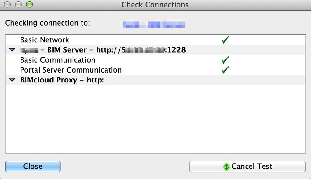

I can connect to the remote BIMserver (over VPN), but when I try to share a project, the "share"-button is grayed out.
I opened the necessary ports on my mac & router (18008 & 1228), but nothing helps (not even turning off firewall temporarily).
Any Ideas on what might be wrong?
PS: working within the servers network (no VPN) doesn't change this...
As you can see on the screenshot, making and managing folders is possible...

Maybe this screenshot may help you... to help me? Please?

I am having the exact same problem. I have tried two different Windows Server installations on different instances in the Amazon EC2 cloud without success. Everything else is working and the Manager is available over the web. Connections are good according to attached image.
Problem 1
I can't share a project because the shared button is greyed out as above.
Problem 2
I can´t upload a library and I am experiencing the same result as B.E.A.T showed in his image above.
Unfortunately I cannot find any solution to these problems in the quoted articles http://helpcenter.graphisoft.com/?p=40585
It is really important for me to solve this problem. Any suggestions?[/img]

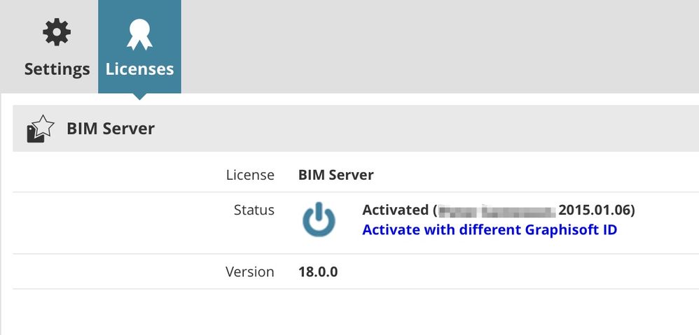

Marton Kiss
It might be really basic, but please double-check that the BIM Server has been already activated.
Connect to it via a browser, modules, BIM Server Manager, Licenses.
Marton

Licenses are ok
Summary:
- Licenses are ok
- Connections are ok (See image)
- But there is no Host Server (See image)
I still can't use share project or upload Library
Marton Kiss
On the modules tab do you have the v18 module listed next to the BIM Server Manager?

No, I only have the BIM server Manger under Modules
