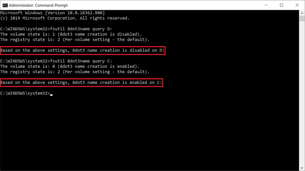

If you are not sure whether if you have such drive, you can check it with Command Prompt:
  1. Select Windows Start menu
  2. Type in: cmd
  3. When Command Prompt appears, right click on it - select "Run as an Administrator"
  4. In the appearing window, type in the following command:
    fsutil 8dot3name query <Drive Letter:>
    e.g.: fsutil 8dot3name query K:
  5. Press ENTER
  6. Based on the current settings, Command Prompt will report you whether if Windows 8.3 filenames are enabled or not on the current drive.
