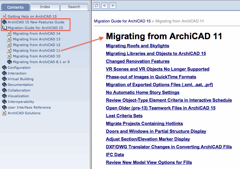

Migration is easy, but you might want to review the pages in the Help file:
http://www.graphisoft.com/ftp/publishing/ac15_help_INT/Files/wwhelp/wwhimpl/js/html/wwhelp.htm
Attached screenshot to show where to click to get the 11 migration info.
Network key vs individual keys: depends on if you or anyone in the office ever needs to take a key home or on the road... You'll get all kinds of opinions on this one.
