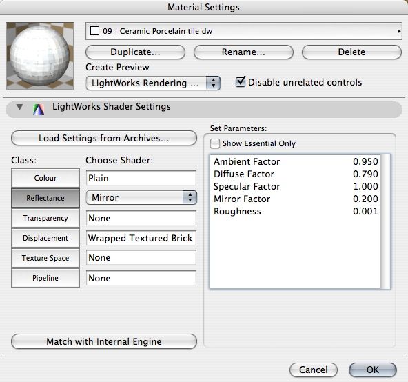

So how about this one, then?
Dwight Atkinson
Dwight
Color shader PLAIN = white
Dwight Atkinson
Dwight
here's the offset
