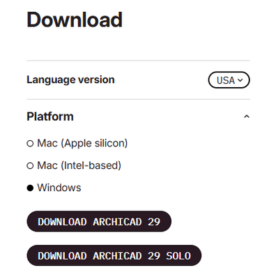

I have just paid for subscription and got an email confirmation to download AC 29...i am suspecting that I should be downloading AC 29 SOLO...let  me try
Lilian Seow LEED AP | cSBA | CAPM | PMP
AC 29 USA FULL | Windows 11 Enterprise i5 3.10GHz | Archicad-user since 1994!
Llian
Oh dear, removed full version and downloaded SOLO and having the same issue...now i have to remove it and reinstall back the full version ...not sure what to do now that i paid subscription and AI beta not working. Any advice ?
