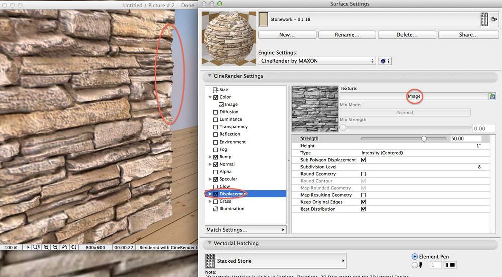

Here's a very quick image from 18 with a stone loaded from the library... and then modified to use the bump map image as a displacement image for the new CineRender engine.
Note the right edge of the wall here, the way it is irregular as if the material was 3D.
