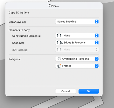

With the marquee tool draw around the model and then press CTRL+C a dialog will appear asking what you want to copy, in my case I selected just shadows (Edges and Polygons) also ensure that it's set to scaled drawing at the top:

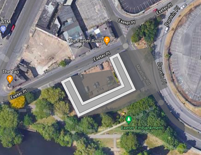

Go back to floorplan and paste it (CTRL+V) and the shadows will appear something like this:
The elements that are pasted are fills which you can modify the colour of if you wish.
