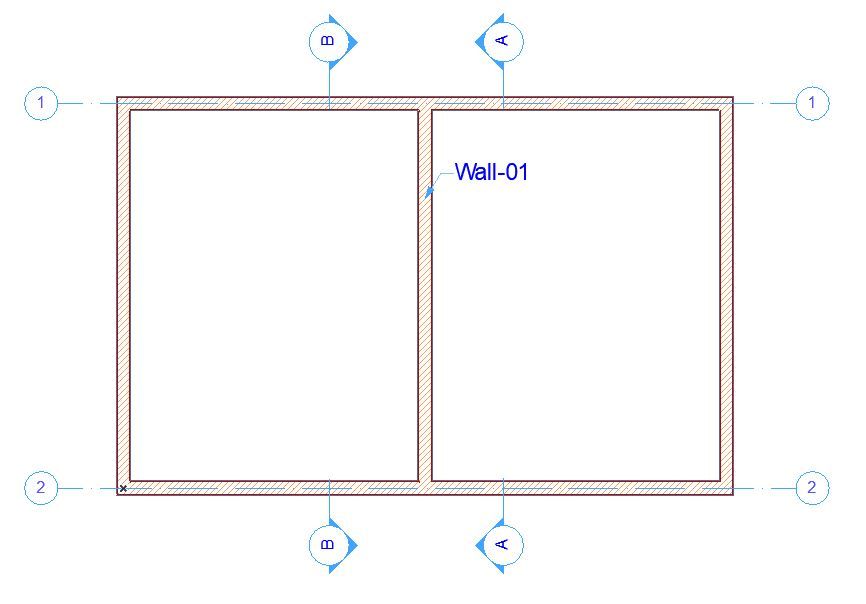

How can we align different textures (inside and outside face) of the same composite wall?
I mean with different origin points.

With a single wall using the wall surfaces, this is not possible.
Unless you have a common point along the length of the wall where both surface patterns match - i.e. the centre of the wall length.
But that may not be possible if you want the pattern set out from each end as you have shown - there may not be any common point - and it would be tricky to calculate.
You basically will need two separate elements.
Either split the wall width in 2 and have two separate walls.
Or apply a thin wall separately for the tiles or a morph surface (for 3D) or a fill (elevations only - not 3D).
