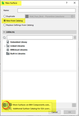

There is a standard surface library included with your Archicad installation.
This allows you to add many new surfaces that may not be included in the default template.
You can load this library (if it isn't loaded by default), and when you create a 'new surface from catalogue', you can brose it to find the surfaces you want to create.
If you have a Select Service Agreement (SSA - yearly subscription), then you have access to an extra surface library.
When you go to create a 'new surface from catalogue', there will be an option to download this additional library if it is available to you - at the bottom of the dialogue window.
There is also a BIM Components link there as well that has some surfaces in it..
