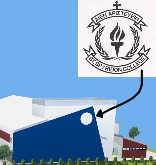

I am trying to texture map a Logo/Crest/Image onto a round element..
Right now I trying to place it on a cylinder object which is rotated to look like and O Front on to the Elevation. But am not being very successful in my attempts as the texture seems to be obscuring despite being on the flat face of the cylinder..
I have created a new texture with the image and am then using the Offset Class to move it around with S and T Co-ordinates..
Is the a circular billboard that exists or a easy way to do this?
So I am trying to place a material to sit centre on a round flat vertical signage element.. which is then place flat on a wall..
Sorry if this is confusing!

Here is an example of what I am trying to do..
There are 7 separate locations where i need to place the same sign.. I have kept all a consistent size excluding to that are a scale down versions..
Hopefully that may make my description a little easier to decipher..

Create Alpha channel in the image of the logo (a white circle in a black square).
Use the of library part "Picture".
muzedesigns
Thank you very much for your response Valery.. Your solution works perfectly! Cheers!!
