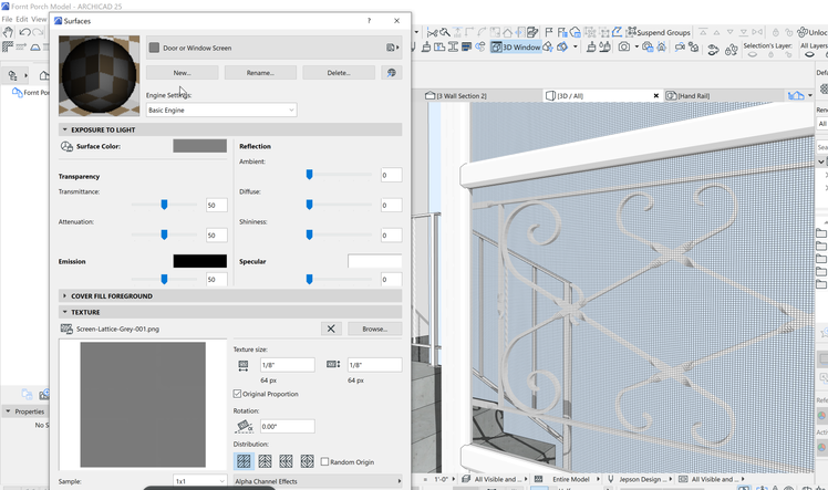

For some who may not know how to do this, it's not something you need to model.  It can be done by just applying the correct Surface to a very thin Morph.  The effect is that the Surface will cut the holes in the screen.
Perhaps ArchiCAD already has this Surface in the Library?  I don't think so.  If not - it should.
In the example below, the screen is a morph plane, with a Surface Override that makes the screen.
Below is a link to a sample image file that can be used for things like this.
These are the settings for the Surface used to make the screen.
This is what the fill looks like if you zoom in close enough to see it.
Add the .png file to your Embedded Library so you can use it as a Texture for a new Door and Window Screen Surface.

I am wondering, based on your experience, does the fact that the texture is so small (64x64 px) potentially slow things down in 3D when there are many element to which this surface is applied? You know, because in that case, there would be thousands upon thousands of this 64x64 texture tile generated in 3D.
But maybe not, today's GPUs can handle gigantic amounts of texture data.
I am just curious about your experience.
Steve Jepson
It would theoretically slow down the program less than if it were geometry, and a whole lot faster than modeling the wires.  Try it yourself by opening the provided .pla in the link above.  You can copy and paste it into a different file and the Surface/Texture will automatically be in the Embedded Library. (for those who may not know that).
The thing is, to apply the screen Surface/Texture would be a very rare thing to do.  Probably for just some special view or screenshot.   Regardless of any possible slowdowns or not (which I have not seen), you would probably switch back to some other invisible Surface/Texture for most situations, and/or have the Mesh it's applied to on a layer you toggle on or off.
It's a technique that has lots of other applications depending on the shape of the image you make the Surface/Texture with.   For example, a chain-link fence or something like that.
It's an easy alternative for people using ArchiCAD who are not interested in learning about the use of bump maps with the ArchiCAD rendering engines.
"Necessity is the mother of invention."   😉
I would also add that you can download that screen door from Turbo Squid for  $3.00  Screen door retro 3D model - TurboSquid 1537330
When you import the .3ds file to ArchiCAD  (File / Interoperability / 3D Studio) and it is converted into a .gdl object,  - the image files for the screen are automatically added to the Embedded Library.
