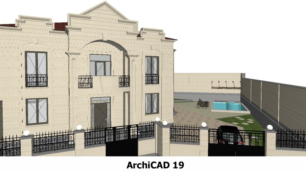

I noticed that images from 3D window saved in ArchiCAD 19 (jpg, png, bmp etc.) have worse quality, than in previous versions of ArchiCAD.
Comparison of JPG files saved with ArchiCAD 16 and 19 can be seen in attachment. Quality is 100 for both.
I tried different options, but did not get better quality.
Is there any solution to this (except PrtScr then paste in Photoshop and crop )?

This is ArchiCAD 19's JPG file. Looks awful.
Quality 100.

Seems like the anti-alias that is applied to the viewport disappears when you save out a JPEG. Odd. After the save, the viewport also loses the anti-alias (until you move, refresh, etc).
Play around with cinerender settings, you can get a very fast render if you turn off effects, use a HDRi sky for lighting (sky luminance) and turn on Global Illumination. I'm talking about 40 seconds per render fast. It will look infinitely better than any saved OpenGL frame.

Just a thought regarding the antialiasing, it is probably not a bug as AC19 now better using OpenGL features and hardware acceleration and the antialiasing is now being done by the graphics card and not in software. This is why 3D navigation much faster and smoother, especially with high end cards.
The less refined image is probably what is done in software.

Have you tried the settings I attached? I'm getting about 40s for a viewport sized render of a fairly detailed and sizeable model. Surely this is as good as saving out a screenshot for presentation?

Hi Rammstein, most of your questions have already been replied to...
In ARCHICAD 19, the 2D Drawing Antialiasing is switched off by default. You need to activate it to get nicer result here: Options > Work Environment > Advanced Redraw Options.
