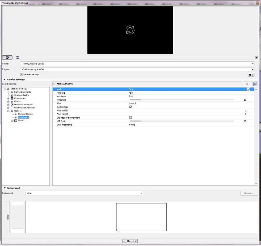

I'm trying to render an external image of a vertical batten facade, but are having great difficulty getting the screen to look sharper. I was wondering whether anyone had a similar experience and knew how to fix the issue.
I have attached screenshot of my render settings.
I'm using archicad 19 on a PC.
Any help would be most appreciated.

All you can do is to increase the resolution
Scott

So is it worth adjusting the antialiasing settings or should I just stick with the standard?

I would just render a larger image as adjusting the antialiasing settings can would require a bit of experimentation and could take longer than just rendering a larger image.
Scott

always try to use Anti_aliasing with Sinc filter (it's there in the drop down menu) so you can get most real and sharp rendering.
