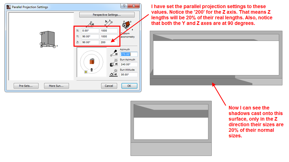

But I realized that in Parallel View I can define a custom view in which I will look at the model from the top, but in a way that I see the elevation onto which shadows are cast. Check the attached image and you will see that by setting those values for the X, Y and Z axes I could achieve a parallel view in which I can see the cast shadows, only they are 20% of their real size in the Z direction.
(Depending on how close of far the shadow casting building is, you may set values of, e.g., 100, 125, 200, 250, 500 which will need to be resized in GDL 10x, 8x, 5x, 4x, 2x, respectively, as seen in later steps.)
But this is something that I can work with to capture that geometry.
So the next step is that I have to capture that geometry and then resize it 5x in the Z direction in GDL to obtain the real sizes. In the X direction the sizes are correct.

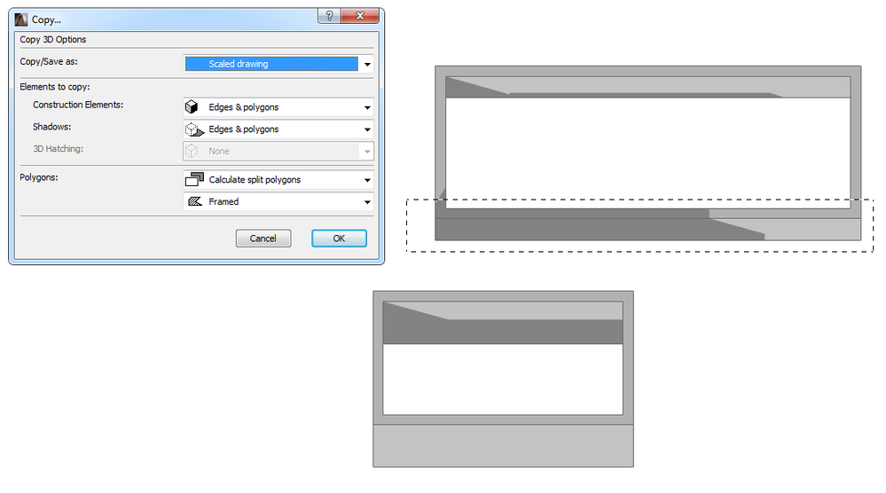

To capture it I can simply use the Marquee.
One important thing though is that you have to switch the 3D Window to the Internal Engine, because if you draw a Marquee in 3D and copy it to the Clipboard, it will paste an image (bitmap).
However, if you do it while using the Internal Engine, the copied data can be scaled vectorial data.
So, switch to Internal Engine in the 3D Engine field of the 3D Window Settings Dialog.
Then draw a Marquee around the projected elevation and press CTRL+C to copy it to the Clipboard. Select the options that you see in the attached screenshot.

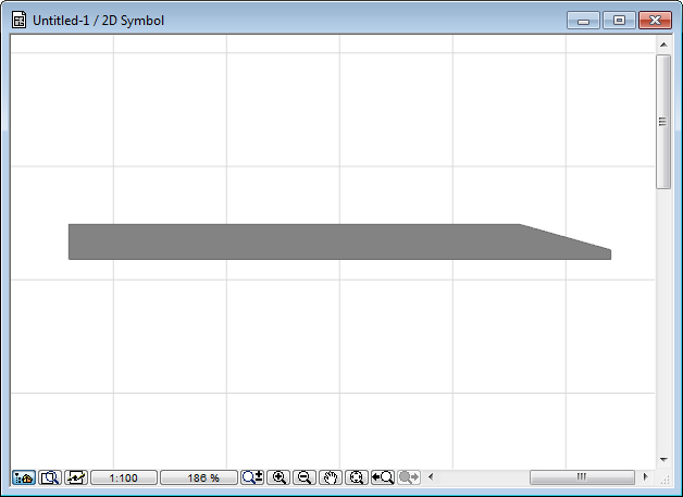

Now we need to do some cleanup work.
Delete all lines and fills that do not represent any part of the shadow you wish to obtain.
The attached image shows what is left in the 2D Symbol Window after cleanup in this example.
One thing I wish to note: if you elevation is staggered, you will need to move the shadows of those staggered segments into one line because that is how you will see them in Elevation. Basically you just need to shift their positions in the Y direction in the 2D Symbol Window.
Now we need to resize this in the Y direction by 5x.
