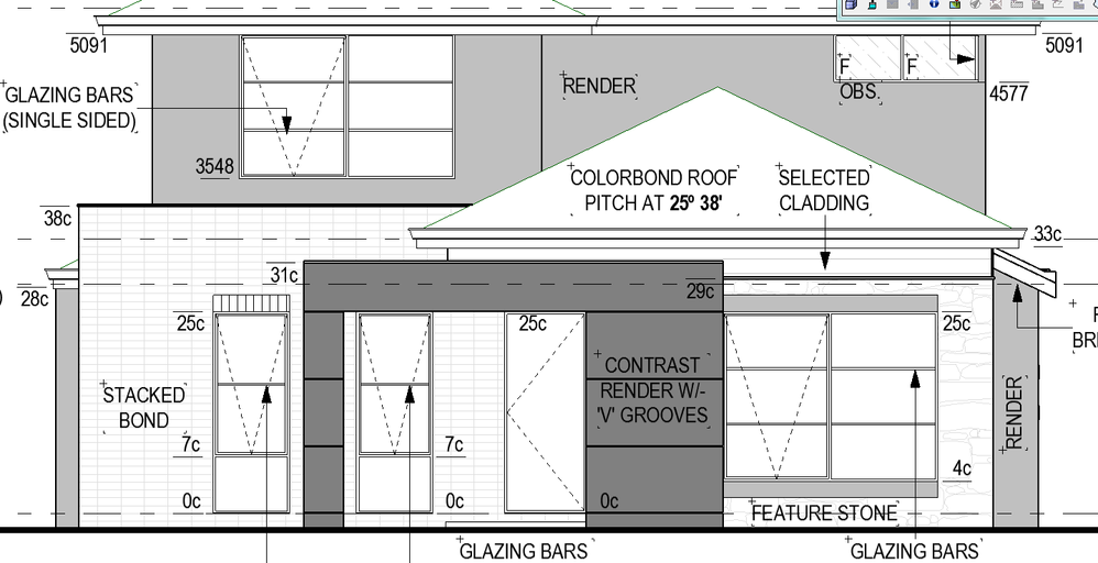

So, here's a typical comments redline.
the lining up of the brick header to the brick sill...not a problem, that's an easy one.
The "making the door jamb and shim spacing" to be EXACTLY the same as the window shim and frame sizes...umm...well, so many different parameters between the door and window that makes it a bit tough finding that EXACT little dialogue box that adjusts what you need but that can be found.
Now, the BIG question I have is.....the architect wants to have TWO or THREE DIFFERENT BRICK PATTERNS shown side by side in views.
Now, My initial thought was, create 3 different model files, import the views from one to the other while adjusting the "brick fill" pattern that's being used in the specific surface I'm showing in elevation.
Because there's no way I can show 3 different brick patterns on the same model in ALL the walls...no way no how.
Fills wont cut it either cause I'd be filling around, on top of, in between, creating holes in the fills, just to show 3 different brick patterns.
So....how would you all show 2 or 3 or 4 different brick patterns on ALL the walls without having to continuously be adjusting the name of the building material and surface material each time?
See...this is the kinda demands I get and on top of that I get to hear "...in autocad we'd just copy the elevation 3 times and change the hatch pattern on three different elevations".........which here in archicad that aint cuttin' it.
Also I guess I could do a "detail" and create a 2D flat FAKE elevation of a portion of the fascade to "study" the brick pattern but then I'd be tripling my work because not only would i have to adjust the 2D detail elevation but I'd have to be messing with the model pattern until the client can get his act straight (the owner of the building I mean).
So folks....what say you?

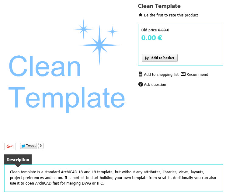

I gave up trying to export my layouts for further editing. Best solution I found was to set up publisher to export DWGs with a stripped down export filter e.g. hatch off, from the VIEWs. That way only the basic and required information was being supplied. I did also include layout PDF's for the finished drawings so the recipient had a full set of information to reference.
AC does a pretty good job of exporting to DWG but it does have problems when exporting everything.
There is a good Clean Template for that -- free
http://www.masterscript.nl/epages/78066077.sf/en_GB/?ObjectPath=/Shops/78066077/Products/101

Don't ever use the same pen for material fills as the wall geometry mate!
It's the same philosophy as in autocad just assigned to the material itself
in lieu of an autocad fill!
