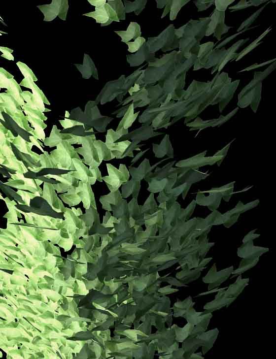

RE: Ivy Generator FREE utility.
Wow!!!
The ivy can be simplified. Each leaf is a UV oriented rectangle with masked leaf applied.
The import to Artlantis does not bring the material in, but the label is there and it is a three step process to map the leaves.
Get this and restore ugly buildings to beauty!
