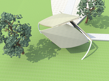

I want to render a plan view of my site which is 70% grass and trees. It will be a parallel view so shading is needed to add depth to the trees etc.
I've added a postcard (default) onto the lawn but nothing appears to change when I render it. Also, when I select the parallel view, my render/view window is completely blank. I don't see anything in the camera view dialog nor when I pan around.
I'm very new to Artlantis and any help is greatly appreciated... deadline tomorrow
Thank You
Not that the attached is for reference, I hope to use a parallel view when I find out why it's not working for me.

NStocks wrote:
I got it working! I think the parallels didn't show anything because none of the layers were turned on...
I've rendered, again the grass looks very poor, I've used the dafault lawn postcards...
Glad you got it! (I was typing while you were posting.)
Even the best grass texture cannot look like grass at that altitude.
For normal scene grass, you can blend textures using opacity to hide the tiling lines, and there are some fantastic free 3D grass objects from ArchiRadar.
But at that distance, you might be better off creating your own "grass" concept by creating something abstract in Photoshop - subtly blurring large patches of green and yellow/brown/whatever , blurring them, and then adding noise as if you were paining the illustration. Apply that texture to your terrain.

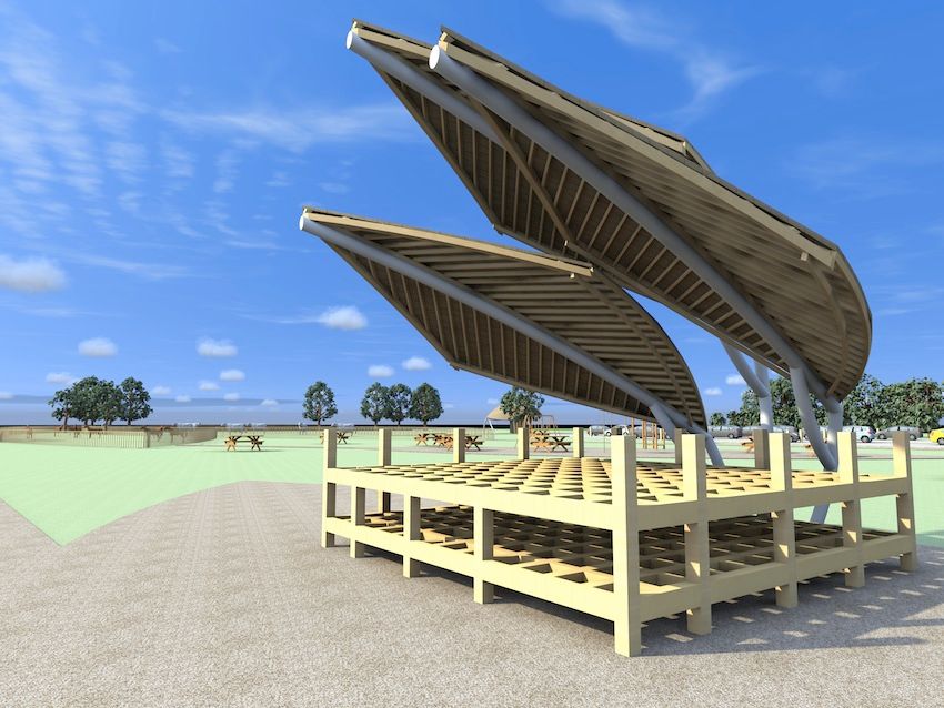

Ok here's what the result is... The grass isn't very good but overall I'm fairly happy with it. The main part I like about artlantis is that everything is 'live' like you see changed immediately i.e sun light, material texture. Also the sky always looks realistic to me. (but sometimes I get a black line between the ground and the sky which I has to edit in Phostshop... how do I move the sky 'down' to meet the ground without moving the perspective camera?)
Thank you very much for your help, next project is urban based (near a train station in a busy city) there there should be plenty of options for rendering there!
Feedback is very welcome, I know it's not perfect but its my first attempt.

Off to a good start for your crash course beginning with Artlantis. Ignoring composition and the story being told, you've no doubt noticed a few things right away about your image, I'm sure:
1. Bad tiling pattern/repeat for the gravel (?) in the foreground
2. Light color / uninteresting pattern for the grass in the background
3. Strange dark line at the horizon
4. Washed out, and uninteresting texture on the wood framing in the foreground
The over-exposure of the sunlit surfaces is due to your settings for the power of the sun and sky. It looks like you set your sky illumination high to avoid dark shadows (and good to see blue-ish shadows). If you want hard edges as shown, then bring down the sun power/etc. Or, change your sun shadow casting to a softer setting and adjust sun/sky power as needed.
There is a setting that lets the auto-generated clouds affect sun power/shadows. That can result in an improvement some times. Try it.
For (1) and (2), I saw that you posted a question on the Artlantis forums and the folks there gave you the correct solution - just looks like you did not implement it? You need to adjust the material response to light, but most important is a combination of multiple quality textures with differing opacity settings so that each is visible as a blend, but with one rotated differently from the other so that the tiling/repeat is in different directions. Also, as suggested on the Artlantis forums, you may need to adjust your bump settings (which will slow down the render though).
For (3), the dark line at the horizon is no doubt because you did not insert the infinite ground plane in the scene inspector. Press cmd-I (ctrl-I) and add the ground plane, clicking on your lawn to set the height and then applying your grass teture to it.
Even with that, it will look odd going off infinitely to the distance, a quick fix is to insert fog way in the distance and low to the ground, and using either a grass green or sky blue color. This creates a band of diffuse color which makes the sky and the ground blend together like a gradient fill. It will still not look natural, but it is a quick fix for prelims. If the real image needs this viewpoint, then you need to place curved wall in the distance upon which you place an alpha mapped (transparent to sky) image that creates the illusion of what is really in the distance. Dwight Atkinson gives many examples of this on these forums (cyclorama) and in his books.
For (4) you need either a different texture if you want the woodgrain to show, or you just need to add some noise so that the surface does not look so clean. (Ditto the very cool leaf structures above.)
HTH,

Thank you for your feedback Karl,
Yes I realise that the gravel is tiled, this is because I didn't change much in Artlantis (I was against time, aren't we all!) I applied texture to the grass, but perhaps I didn't increase the bump enough or I didn't layer enough images, as suggested in the Artnatis forum. Also the grass area is huge and Ididn't use a image that filled the complete area whch meant it was stretched which then increased the blade size, which then meant it looked unrealistic
The black line was a photoshop result, as I had to photoshop sky because I didn't select the infinite ground plane
Regarding your latest post, I have already taken a panorama of the site, perhaps I should post it as well... the site itself is an empty field, of which is to become a 'natural burial' with an area for the local commonity and farmland. Is this why the composition looks poor? Should I have chose a different angle or something?
I have another day or two until the next project starts, so I should improve my artlantis skills in readyness for the next deadline (8 weeks)
Thank you for your feedback, I apologise if it looks like I'm ignoring other adivce, this is not the case... technical dificulties at Uni meant my time was even more limited so it was a somewhat 'rush job'.
I look forward to correcting and learning artlantis and I can see great possibilities in this and I forsee that my preference for rendering will be artlantis...
