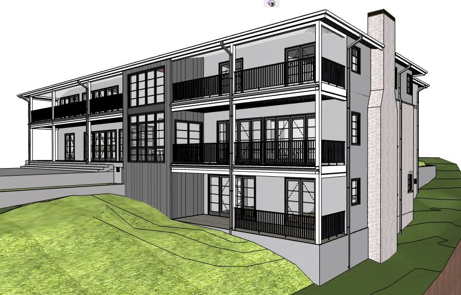

I have greys, whites, brick tones, etc...in my building model.
I've set the "material" and "textures" and "surfaces" so that the "Cinerender matches Internal" look of the material....yet when I render USING the Cinerender engine...my building, the entire building looks very "yellowy"?
How,where, who, what can I adjust to get the renderings to render better?

I mean..here's what the "screen" image looks like? why can't the rendering be, look, more like this?
this Cinerender is the most complex rendering program I've ever seen.

You have a yellow sun colour, if you are using physical sky and have late afternoon time this is what you will get, you can change the colour of the sun in the rendering settings physical sky section.
Cinerender is a much more powerful and therefore much more complex rendering engine, once you have experimented and saved your settings for use again you will find results and speed will be much better

Possible quick fix (under detailed settings):
Use Physical Renderer > Physical Camera > Camera White Balance
That might be set to something else than daylight.
The Outdoor Daylight Fast scene should get you decent results though. You may have to go in to the Options > General Options page to change the Ray Threshold / Ray Depth / Reflection Depth settings if reflection and transparant materials are giving unsatisfactory results.
