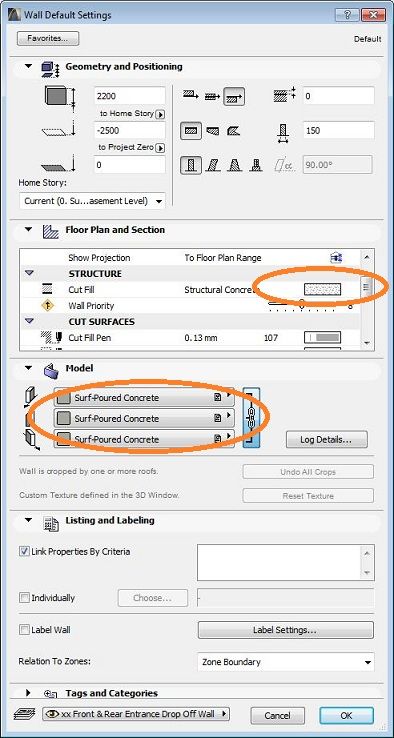

Can we import our own structure/cut fill and model surface?
I found the structure/cut fill and model surface is limited.
I hope I can import the both of the item using the photo I taken from the real material to make the 3D view more realistic.
Have anyone try this one?

unfortunately you can't use image fills as cut fills in ArchiCAD. But you can use image fills for model surface and other fills.
If you exploded your walls in floor plan you could use an image fill as the wall fills. An insulation photo or wood for example.
When you open a drawing from autocad or other cad program ArchiCAD will automatically import the fills into that drawing file. You can use the atributes manager to save them or load others.
