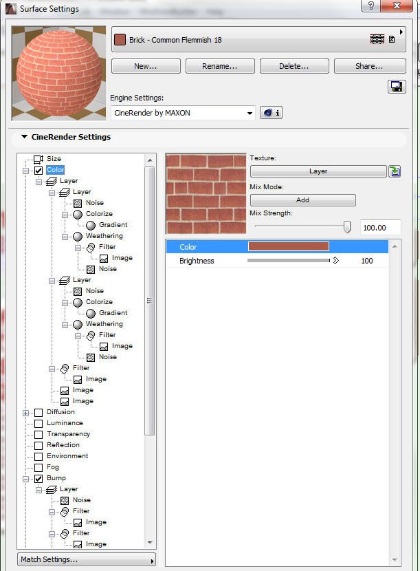

I am trying to achieve a common flemish pattern with the brick shader.
1 - Is there a way to add a feature such that I can make it such that the row that have alternating End row width have another option to say how many end pieces you want and alternate with the normal side?
2- The other option would be to add under the Tile shader more brick patterns? Any way to do that?
Thanks in advance, any help or suggestion would be great.

Have you tried the standard 'Brick - Common Flemmish 18' surface?
Check to see if you have it.
I am not sure if it is standard with Archicad or part of the 'Additional Surface Catalogue' for SSA users.
It doesn't use the brick shader at all - probably because it can't do what you want.

Hi Barry,
Yes I have that Texture and I used it as a starting point but when I wanted to have a brick blend, I ended up recreating my own texture to represent it.
I like the Brick shader better and wish there was an option to make the coursing I was looking for.
Thanks again
