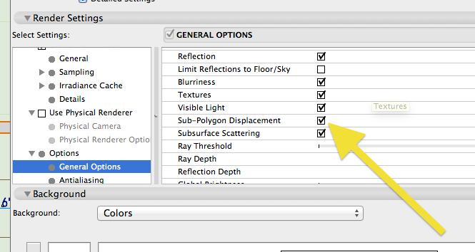

Karl Ottenstein
Moderator Emeritus
Under Options > General Options
It is disabled for the "Fast" predefined scenes, such as the one you show in your screenshot.
AC 29 USA and earlier   •   hardware key   •   macOS Tahoe 26.5.2 MacBook Pro M2 Max 12CPU/30GPU cores, 32GB
Eduardo Rolon
This one?
