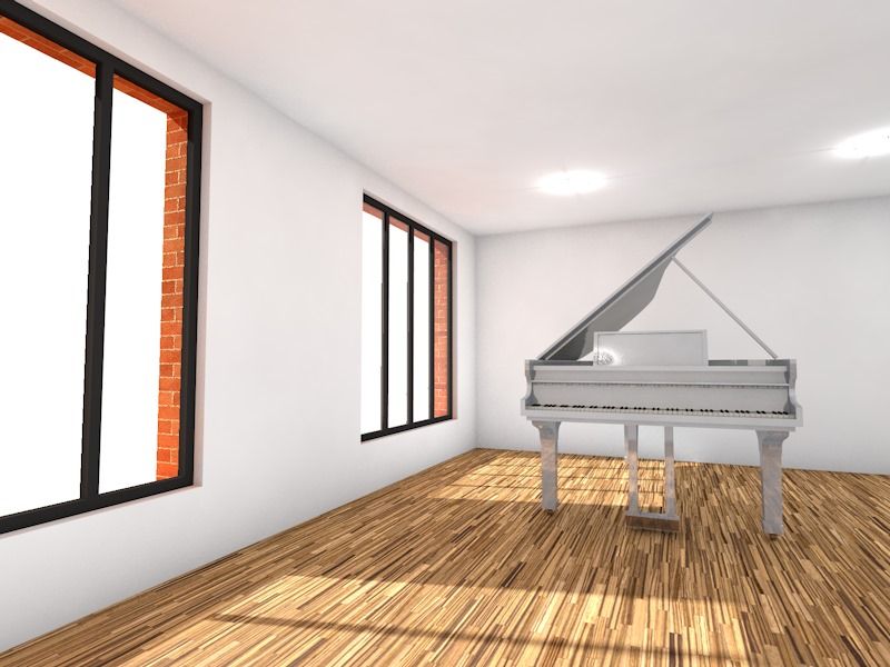

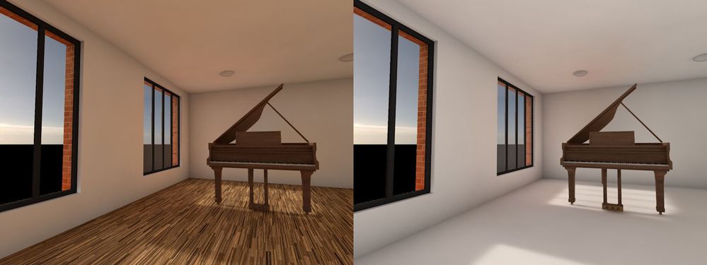

Basically, having done some testing I understand that when rendering in cinerender (specifically I am using 'Indoor HDRI Medium' slightly modified) the colour of surfaces that light hit is then bounced/transferred onto walls.
So I have for example a scene where I am using a parquet wood floor which is giving the room a slight brown/cream appearance. What do I change in the material setting (or in the cinerender settings?) to override this?
The below image is the same render settings, the only change is the floor material. I'd like to try and get white walls in both renders 🙂
Many many thanks in advance!

I'm not sure how I didn't work that out now you've pointed it out! Makes complete sense. Thank you so much! Just for proof that it worked for anyone else reading see below. I went to the extreme and switch saturation to 0% in this instance. Wonderful!
