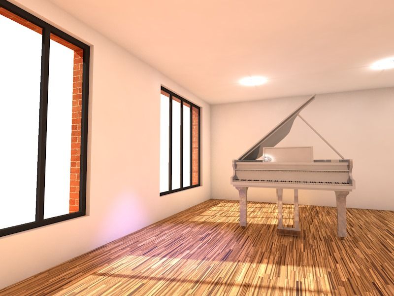

Thank you for your reply. Unfortunately, I haven't got it working yet, I'm wondering if something in the actual Cinerender settings is overriding the light? I'll have a dig around but this is what I got so far see below

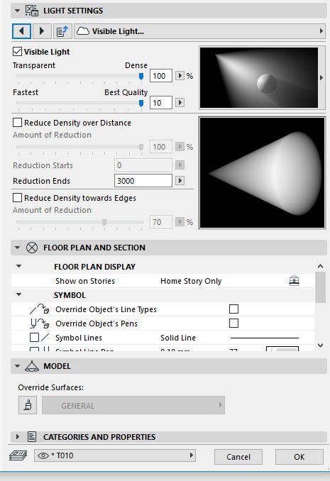

Heres the lamp settings (for purple spotlight which you can just about see illuminating part of the floor).

I think the settings you are looking for is Visible Light rather (aka volumetric light / god rays)?
A few of the lightsources offer it, such as the General Light and the spotlights.

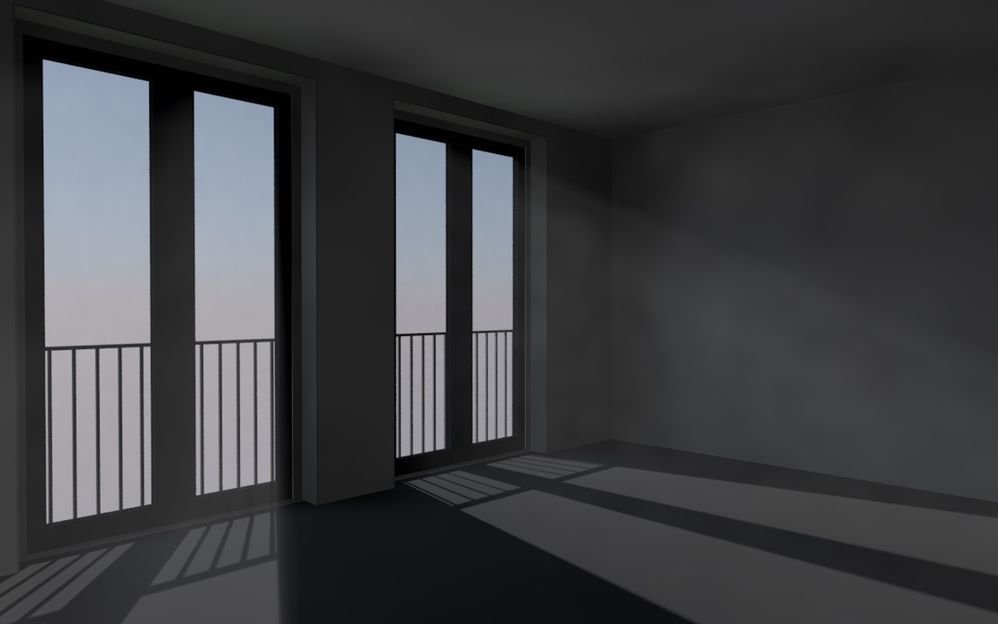

I did a quick test.
Drop a general light with infinite strength outside, a little up in the air from your window, aim it (it has arrow with hotspot in 3D) at your window. Do not use the sunlight in cinerender, on Lights.
Turn on visible light and noise in the light settings.
Turn on caustics in cinerender.
Make sure the surfaces you are using have the caustic channel turned on too.
Below is the result. I didn't fine tune yet with colours etc. but you can see a little bit the rays of light.

I used the general light, it is more basic as it were than the spotlights, so render times aren't that dramatic. Still a lot more than not having the fancy smancy things.
It's a ball of light basically, it will be very tricky to replicate the excact angle of your sun, so I would just turn it off and have this behave as 'sun'.
One fake computer generated 'sun' is as good as the other 😉.
Do some test renders at lower settings, before settling on a final render and coffee break!
