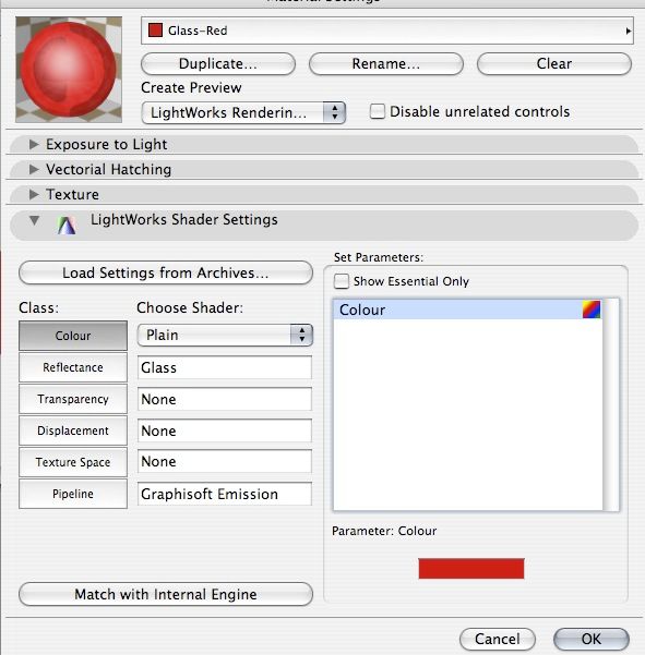

sample image then 3 settings images
settings 1 of 3
settings 2 of 3
settings 3 of 3
Thank you very much Mike, you have literally saved my sanity...
