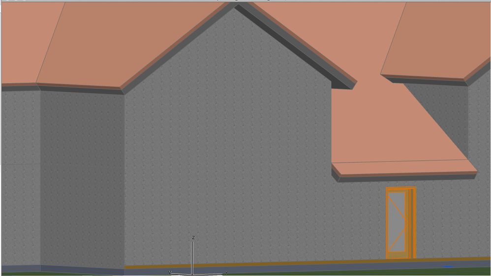

I am trying to use a white render effect on my building. I selected "white stucco" as the surface. The surface looks grey. How do I make this appear as it should? I've attached an image as a file attachment.
Kind regards,
John

From your screen shot it looks like there is a texture applied to the material (Surface), you can check this by opening the Surface Settings (was Materials Settings before AC17), selecting the stucco material and looking at the Texture panel in the dialog box. You can either remove the texture from the Surface, or select another texture that is whiter, or increase the Ambient and Diffuse values in the Reflection part of the Exposure to Light panel of this dialog box.

Thanks David, I've now achieved the required view! Thanks for your response!
