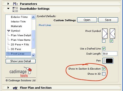

i'm annoyed that the sliding door opening arrows show in the render - they should be classed as a part of the vectorial hatching rather than being '3D elements'.
You can simply switch the arrows off in '3D Representation' of door settings (in case you don't know that already )
i did. but then how do i get the arrows on the elevations and sections without manually turning it back on?!
i think that 3D documentation elements - such as door arrows and 3D information text - need bundling under a new 'non-visualisation' category of elements . . .

~/archiben wrote:
~/archiben
You may recall, ~/ben, that this is available in Door & Window Builder, available from CadImage.....(I should be on a commission).
DWB only available from yesterday on a mactel mate . . . but thanks for the heads-up . . .
