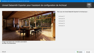

Datasmith Exporter for Archicad 28 (For use with Twinmotion)
TechnicalSupport_REI
The latest version of Data Smith can be used with ArchiCAD 23-27, but now ArchiCAD 28 has been released.
Twinmotion Datasmith Exporter plugin for Archicad - Twinmotion

The updated Datasmith exporter, which supports AC 28, has finally been released.
https://www.unrealengine.com/en-US/datasmith/plugins
