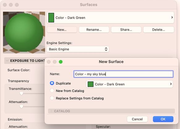

The easiest way to create a new surface is to click the "new" button in the Surfaces dialog with a similar surface already selected and then duplicate that existing surface.  Then, modify the duplicate to be what you want.

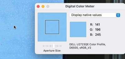

You don't say what platform you're on.  If you're on Mac, there is a built-in app called "Digital Color Meter" that lets you get RGB values from an image... averaged over a  resizeable square that you drag around on the image.  Windows has something similar, but I don't know what it is.  This is more useful than the eyedropper in the Archicad dialogs which gives you the RGB values of the pixel it is over... so if you have a PNG/JPEG of a color swatch which has noise in it (highly likely) you may just happen to hover over the wrong pixel.
Here's the Digital Color Meter on a Mac with the mouse hovering over an area of sky to get an average value for the blue visible - not seen in the screenshot is the rectangle that is made larger by sliding the Aperture Size slider to show which area will have the pixel values averaged to produce the resulting RGB value:

In the Surfaces dialog, here I've picked one of the built-in 'color' surfaces (which has no textures)... and clicked New to create a New Surface that is a duplicate of this one...

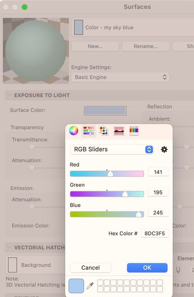

Now, I've clicked on the "Surface Color" color rectangle ... which was green - duplicate of original - and entered the RGB values that I read off of the Digital Color Meter... now showing that sky blue for the swatch after I "OK"...
Note that all of the other sliders will determine how the surface responds to sunlight and ambient light.
